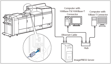

Connecting the Machine to a Network
Connect the RJ-45 connector of the machine to the port of the imagePRESS Server. Cables are not supplied.

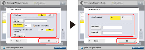

5.
Press [Proxy Settings] for [TCP/IP Settings] → Press [On] for <Use Proxy> → specify the required settings → press [OK].
